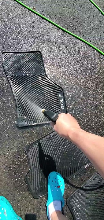

An yways, tested it out a bit... Pressure washer doesn't seem to like turning on when i press the trigger... orifice too big or too small? Doesn't matter, there are no markings on the box as to the size. I am taking the m50 to Princess Auto and getting the 3.5 nozzle they have in stock...
video with stock nozzle. I didn't capture the video of the 2 front matts being pressure washed, but the trigger and machine worked as it should for the 1st 2 matts...
seems fixed. bought a new nozzle at PA. Ran the washer for about 5 minutes misc cleaning parts of our driveway. No issues with starting or stopping the spray.
Took a close look at the nozzle that was suppled with the pressure washer gun. Looks like a piece of scarf/metal is stuck in the orifice of the nozzle. Probably left over from manufacturing process in either the new hose or gun.
