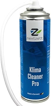

It's sort of a combination of the environment where the car is parked, how often the re-circulation or fresh air is used, how often A/C or heat is used, etc. I've had it happen in other cars I've owned, some more often than others, but every one of them at one point had the musty smell happen at least once.
I believe dealers would use something similar to this product, which I want to say someone at Toyota told me that's what they used and I've purchased it before. It does work and clears the smell, but like @cruzer666 said, for a while.
